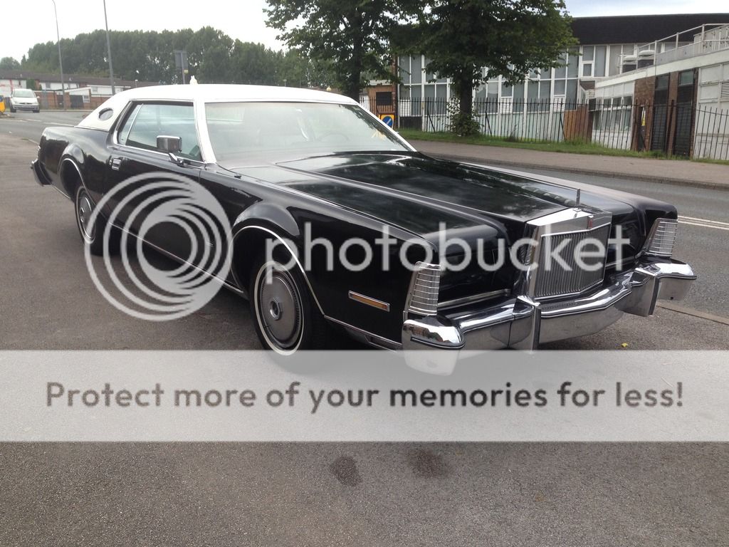

It looks great in black with white top,i think so anyway but then i knew what it would look like as the first one i ever saw in the UK was that colour.It was 20 odd years ago and that was the car that made me want a mkiv.

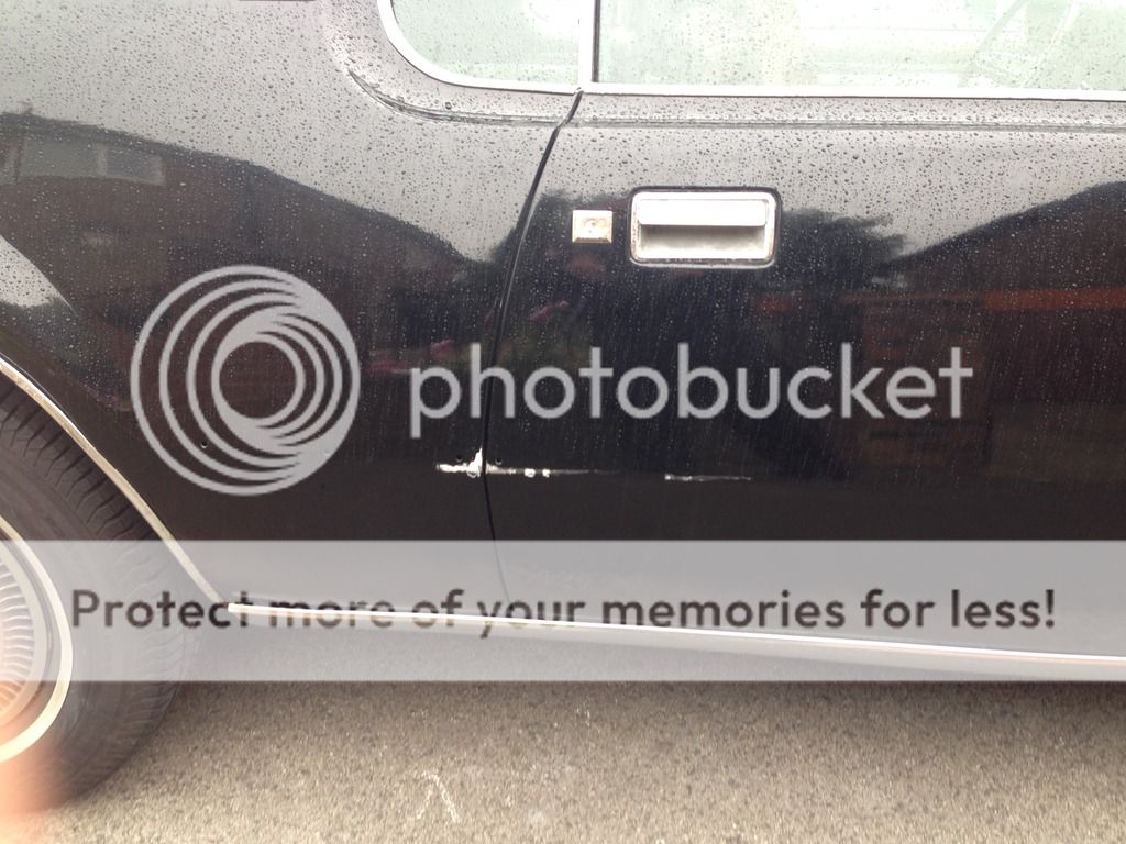

The paint job itself came out really crap,my prep wasn't good enough.I had to scrape all the top coat off and doing that i managed to take bits of the primer off underneath.So there were patches that were bare metal and i just kept sanding until it looked smooth around those areas.I primered and it looked good but when i put the colour on you could see all the waviness underneath were i had gone to bare metal in places.Plan now is to do it again but go to bare metal doing one panel at a time.You can see from the pic that bonnet didn't come out too well.
