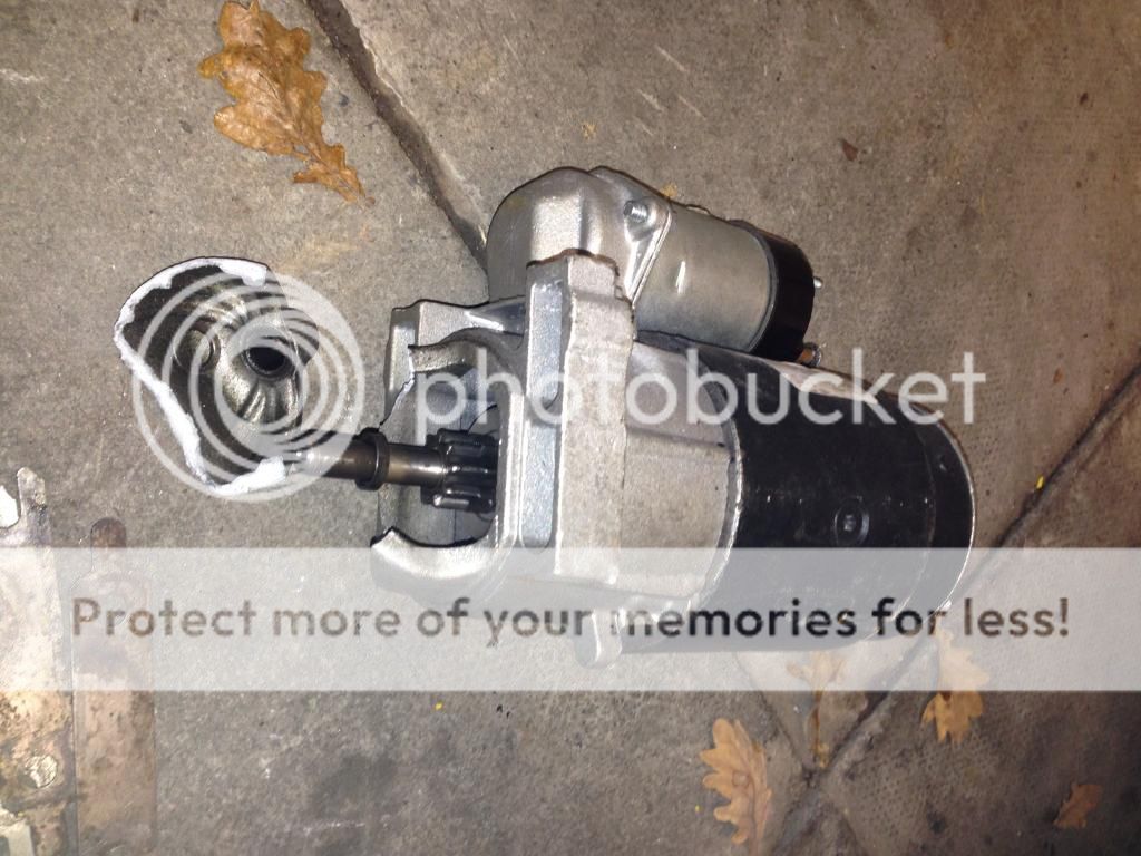

After breaking the new mini starter that i bought i decided to try the old starter again,was a bit hit and miss,sometimes it would turn over slowly and sometimes fast enough to start.When it was turning over it was loud and i though it might need shimming so added some,then it stopped turning engine over,so bought another standard one.
Here's my old one when i took it off,i say old,it's actually only about 12 months old.

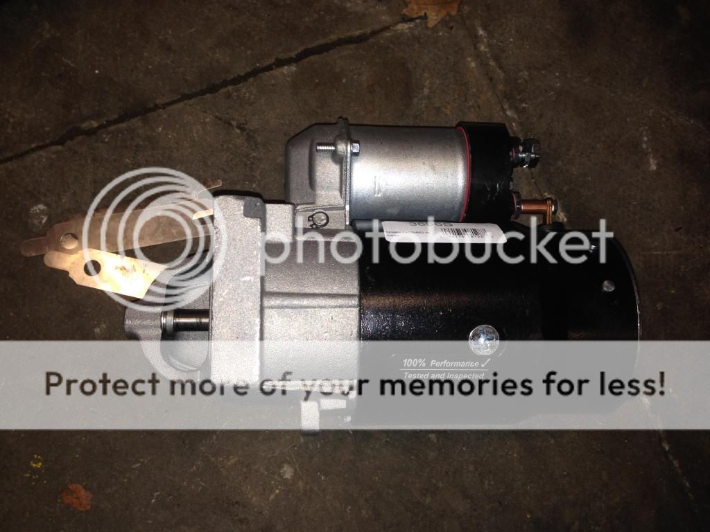

Here's the new one off ebay from USAuto,only £55 delivered.Still have same problem though with slow and fast turning and noisy.Not sure if it needs more shims,already got about 7 shims in there.

i had one one my 400 had it off and never really knew if i put it on right either . turned it ok tho

My car has its original starter when it got a bit lazy I put an extra Earth on it that sorted the problem 14years ago and it's still going strong Very Happy

I thought it was a header problem at first that's why i bought the mini one,although headers are wrapped,i put a earth cable from chassis to one of starter motor bolts but that didn't help either.
Seems odd i have only had this problem since the engine wouldn't turn at all and i found the washer against the push rod.

Post by Bandit Sun Dec 07, 2014 1:14 pm
Been  looking for shims this morning but couldn't find any,so took starter off to see how many shims i had used,9 in total and just short of 7 mm thick altogether,that's ridiculous but gonna have to make one,probably out of steel bar just to see if it does need more shimming.

Post by thirdgen Sun Dec 07, 2014 1:50 pm
i dont think my mini had 7 on
New starter  Empty Re: New starter
Post by Webbel Sun Dec 07, 2014 4:42 pm
My mini didnt have any shims...worked fine
Post by SUPERCHARGEDGTA Sun Dec 07, 2014 7:08 pm
last one I fitted only needed 1 shim

Post by SUPERCHARGEDGTA Sun Dec 07, 2014 7:10 pm
you sure its got the right flywheel/flex plate?
is starter ring ok?
Post by Bandit Sun Dec 07, 2014 7:42 pm
With the starter that just broke i am sure i had 3 shims and never had a problem with it for about 12 months,then i had the starting problem when i found the washer in the head.
The flex plate is same one that's been on from when i fitted the 400 engine,i have been thinking maybe it's warped from when i was messing around trying to get the mini one to work,but wouldn't think that would affect shimming,but maybe it's what's making it noisy turning over,i just assumed it's a shimming problem.
